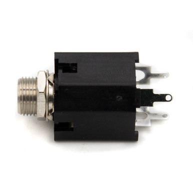

Hey all,
Sorry if this is a silly question, but I couldn't really find much about it through searching so I'm curious what you all think about open vs closed frame jacks. I personally like open frame more since I have an easier time differentiating the tip vs sleeve, however I'm wondering if there are uses for closed frame jacks that I'm unaware of.
I saw a drill template on Aion FX that said open frame jacks won't fit inside enclosures that have 5 or more knobs. Is this generally the case? Or is it more of a case-by-case basis? Right now I pretty much only have open jacks in my inventory, so I'd like to save myself the headache of getting a pedal all wired up and built only to find that the open frames are touching the enclosure, that kind of thing.

I think you hit the nail on the head here. If you prefer open jacks, use them, but on your next order you may want to grab some closed jacks to stash on hand if you ever find the open ones aren't fitting.
On a recent build, I underestimated the length of my wire from switch to jack, and I realized it wouldn't reach the open jack once after I had already soldered it to the switch. Rather than unsolder the wire and cut a new one, the closed jack came to the rescue. Its solder leads are closer to the switch, so it fit perfectly. Always nice to have options.
manfesto
I used to use the Tayda closed frame jacks because they're $0.45, reliable, and switching TRS so can be used for anything.
Now I mostly use the @StompBoxParts closed frame jacks with the teeth that bite into the case:
Because they'll bite through paint and make a solid ground connection and they won't come loose, but I still keep some of the Tayda ones on-hand for switching applications.
You can also get mono closed jacks if your primary concern is being able to easily visibly distinguish tip and sleeve; on closed frame jacks, sleeve is usually the extra "flat" side.

I started out using the cheap closed from stereo jacks Tayda sells, but switched to the open mono ones because the simple two lug setup was easier for me to not fuck up. The open ones look better to me as well, though I realize that's low on list of why to use them compared to other factors like quality and durability.

I now use lumberg open frame jacks or the Stompbox parts closed frame jacks that dig into the enclosure depending on the space I’m working in. I also use the enclosed switching jacks (where they have an N/C and a N/O connection for each pin, so 9 pins total) a lot for weird mono/stereo/dual mono configurations and stuff. I really love the Neutrik enclosed switches stereo jacks too, but they’re hard to find in solder-lug varieties, and I don’t often have situations where I’m using board mounted jacks (though I specifically design a lot of my own stuff to use these because I absolutely love them) and they’re pretty damn bulky

I used to always use the cheap closed ones from Tayda and I loved them, but when I switched from side-jacks to top-mount jacks they stopped fitting in a lot of my builds. So I grudgingly switched to the Lumberg KLBM3. They're the best open frame out there, but they certainly charge for it. Also every few months they seem to disappear, everyone runs out of stock and I frantically look everywhere trying to source a hundred or so to keep building.

I am still in my journey of experience, but I have found I lean toward closed jacks, I have a paranoia that an inserted cable will hit a wayward wire.
Lumberg klbm 3 are awesome, and I would go that route if I could ever find stock in europe.
Most importantly is having a ground which connects to the enclosure, I did an order which didn't do that and I had to run ground wires to the enclosure. A PITA indeed.
Currently enjoying the Amphenol ACJS-MHOM, by bending the pins you can make it really low profile.

I will only use Switchcraft, Lumberg or Neutrik jacks. For me the brand is more important than the type except for tight locations such as a 1590B enclosure. That's where I use Lumbergs. Cheap jacks crap out, it's as simple as that. And if you shop around the good ones don't cost too much more.
If you are reasonably careful about wiring then open jacks shouldn't be any more of a problem than closed.

I use the knock-off switchcraft open-frame ones from LMS. I’ve never had an issue…or at least an issue that could not have been solved with more accurate drilling. Occasionally I’ll have to file a few mm’s off the wafer…

Another silly question, if I have a jack that's slightly touching the side of the enclosure (the round area up on top of the jack is pressing against the screw area of the enclosure), would covering that part of the enclosure in electrical tape or something like that prevent shorts? Obviously it's not a habit I'm trying to get into, but in a pinch, I'm wondering if it will work.
Feral Feline
Depends on what part of the jack is touching, and whether or not that jack needs to be isolated.
I've had a few tight builds where my Lumberg-alikes were touching the enclosure's screwy corner, but it didn't matter because it was the ground that was touching and the circuit didn't require isolated jacks. ✔️
Now if the tip or tip-lug is touching... 🚫
