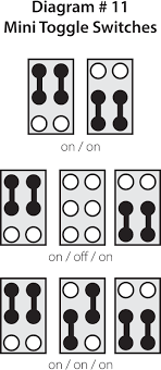

Thinking of running all high gain in sockets or a trimmer, haven't decided yet. Any thoughts on how to wire a couple of 3-way toggles to the 4-dip switch PCB ports so that you could select them Boost/OD/Dist?
Basically, Boost is (Down Down), OD is (Up Down), Dist is (Down Up). I'm not exactly sure which toggle I could use for each side or how I would wire them?

both sides clean boost : off off off off
red side OD, yellow side Boost (factory setting) : ON off off off
red side clean boost, yellow side OD : off off ON off
both sides OD : ON off ON off
both sides DIST : off ON off ON

Hey, this is 6 months late, but for you or anyone else reading, use a DPDT on/off/on switch(middle one in image). dpdt.png
In the left position, the one pair of dip switch ports should be connected, and in the right position, the second pair of dip switch ports are connected. In the middle position, neither are connected(boost), so each toggle is assigned to a different mode.
