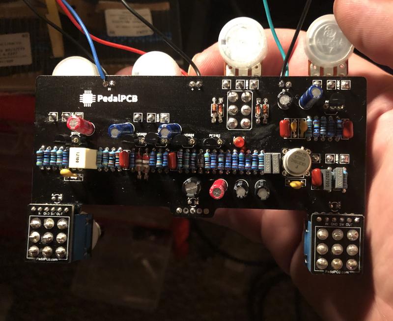

Parentheses Fuzz (in progress)

noob question regarding film caps. How are you deciding to use them and where? Does it matter if I got all film? Also, I mistakenly got a polarized electrolytic for that one large film 1u. guess that won't work. Still getting confused on parts orders.
your clip sounds great
Tonally it won’t make a difference, I usually use ceramic caps for Pf values as the lead spacing on the board is usually smaller but film will be fine, looks like normal 5mm spacing all across this board.
RE: polarized cap...it can be done but I’d need to see the schematics to know the polarity. You can also connect 2 2.2uf caps up to be functionally bipolar. Solder the 2 positive legs together and the 2 negative leads are now your cap legs. Connecting them in this way will give you about 1/4 of the combined capacitance so close enough to 1uf while you wait for the proper cap to arrive :P

hi all,
there are three tantalum capacitor, 4µ7, 2µ2 and an other near the op amp, can someone tell me whish one is it ?
Not sure I follow the question, the 4.7 and 2.2 are electrolytic and other than that I’ve used film and ceramic 100pf and 30pf ceramic caps (the little yellow ones)
Ok, sorry. On the photos of the EQD circuit we can see 3 tantalum capacitors. One is 2μ2, the only one, so no problem. Another is 4μ7, ie one or the other, a chance on two. And the third, I do not see but it seems close to the op amp.
