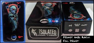

This is the Runoffgroove Tri-Vibe, so thee named: KORE. I have finished the build and I took pictures along the journey so I could Share them with you. The board is from Aion FX and I also bought the input/Output Module Kit. The enclosure took labels very well and as you can see the finished project is very clean. So, enjoy the pictures! BTW, Awesome pedal, very useful both clean and dirty! Also as a side note, this is the first build using a new LED that is designed to go in with the footswitch. I think the images will give you a better idea.

Dig the wraparound graphics! How do you like the sound? I have an etched board from when it was the only affordable way to do it, but never have gotten around to it.
I really like the sound. You can get a full treble like effect to a mellow chorus effect and everything in between. I think it is called a phase 45, but I call it a groovy vibe with the right riffs. I would not say it would be used on all your songs and riffs, but it would be a good one to have on hand for when you need it. I would recommend dusting off your etched board and build it!
