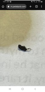

Well, I think I mentioned in another thread that I was having some issues with the pot I got from SmallBear for this Wah.
I had ordered the "Black Bear" 100k pot. And it got scratchy within a couple days of use.
So I sprayed it out with contact cleaner then compressed air and it worked fine for a couple days then got scratchy again.
After two cleanings I'd had enough and swapped it out for the Dunlop pot that came with the Crybaby host. Which worked fine.
I was going to try to exchange it at SmallBear, but then read this on their FAQ:
"My Dunlop/Black Top/ProPot has gotten scratchy. Can I quiet it down?
All of these pots, as well as the SBE Black Bear, are variants of an industrial pot that was developed originally as a joy-stick control. Based on a lot of anecdotal evidence and testing by some SBE commercial customers, we conclude that the lubricant that the maker puts in these picks up dust in some environments, and that sometimes makes the pot noisy.
The present version of the Black Bear is deliberately made without that lubricant. So far, we have not had complaints of shortened life, or of scratchiness. As for the other types, the scratchiness almost always disappears if you diasassemble the pot completely, wash the parts thoroughly with Deoxit or similar solvent, and reassemble."
So I thought I'd give that a shot first. I've never disassemble a pot before.
But when I got it apart some black bits fell out. I guess they were too big to get "sprayed out" with the contact cleaner.
Looks like little bits of rubber. Anyway, put it back together, re-swapped it with the Dunlop pot and now it works great...(so far, heh)
