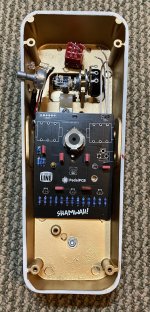

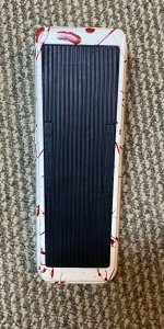

So I made this one for a friend. He is the singer/guitarist in a band and his son also plays and is a huge Slipknot fan apparently.
When he found out I mucked around with pedals he asked if I could make one for his son.
He loves wah/modulation and any weird noice machines.
I hadn’t made a wah so thought why not. I scored a used shell from market place for $25CAD which wasn’t working. Fine with me!
A bit of repainting and trying to think of what a teenage metal head would like and I had finished the enclosure.
The build as always from @Robert went smoothly.
As per advice from @Guardians of the analog i used an area51 inductor and also wah pot too.
I mounted the trimmer externally to have some fun with and hey presto it worked and sounds absolutely fantastic.
Thanks to Spencer @amplifyfun for the name plate.
I’m now keeping an eye out for another broken wah to make one for myself.

That looks awesome.
I haven't made a build report yet, but I just converted my 595Q crybaby over to the Shamwow pcb. I reused the 2pdt switch, trash can inductor, and pot from the crybaby. Looking at yours I think I might have wired my pot backwards. I tested the dunlop pot and it is a c100k pot.

Fantastic build man!

Once I got the old wah shell it was, as usual with PedalPCB's very easy.
I know @MichaelW had an issue with his Smallbear pot and @Guardians of the analog sold me on the area51 stuff. To be honest Dan Albrecht who runs it was super helpful too!
