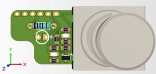

I just finished the last of my customer builds for the month and I still have a few days before I start on the next, so I took the chance to play with the Black Eye build that was sent to me, and I was able to get some oscillation with it, so I have something to start with for figuring this out. As such I've suspended sales of Black Eye PCBs for the time being.
One thing I'm going to play with is a buffer in front, and if I find something that works consistently I think the easiest solution will be to redesign the footswitch board to put a simple buffer circuit on it. So you don't need to modify the main board, just remove the previous footswitch board (easier said than done, I know) and drop in the replacement with the buffer on it.
I'm going to try breadboarding this up tonight to make sure it fixes the problem, but this is my idea for an add-on buffer. It's a relatively tight fit, but if I use SMD parts I can squeeze a simple input buffer on the bottom side of the footswitch board without changing the dimensions. The pedal will still be true bypass, this would just come between the 3PDT and the actual Black Eye input.

So I soldered up a simple buffer on vero last night and was able to get rid of the oscillation, but it was super noisy, so I'm going to try a different buffer and see if I can get better results.

Upon recommendation from a friend I decided to try Jack Orman's "amplike" buffer. It's not as tidy on the footswitch board, but it still fits without having to resize it. I had to slide the CLR over, but the LED is staying in the same place so it can still be a drop-in replacement without modifying the drill template.
Same story as yesterday, I'll throw it together on a vero tonight and try it with the Black Eye I have on hand, if it works I'll go ahead and order boards. I may order a small quantity first as a design try-out, but it depends on cost difference. Sometimes it's only a few bucks difference between ordering 5 and ordering 50.
