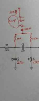

Another note, I did also disconnect the Scoop control, which is wrapped around C13 (22n in mine) and that didn't have any effect on the volume issue
Scoop control? I don't see that in the Build Docs. If there are mods, you need to tell us about them.
Yes, there are a few mods. The original build thread is linked in the OP
Here it is again
The scoop control puts 10k on either side of C13, with the other end of each soldered to a 100n, which is soldered to lug 3 of a 10kb pot, with pins 1&2 tied to ground. Like -
The other mods are your Contour and Drive pots, and red LEDs for clipping diodes

Your schematic above is not from the Pandora's Box schematic. Show us the mod on an actual Pandora's schematic.
