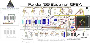

Actually had some spare time the last few days to a) measure how long each wire needed to be, b) cut and strip them and bin them by size, c) attach and solder to the board. About 8 hours. I'm slow, arthritis and all. It's been a long time since I built an amp and I'm getting back into that groove.
Something I did this time that I haven't done before, I make some rulers in Visio and used them to virtually measure the length of the wires I needed. Tested the first few and it worked like a charm! To like the 16th of an inch. I strip each wire to 3/16" of an inch on each side, and used that to come up with the size needed. On the layout below you can see the numbers next to the turret that represent the length of wire needed.
This was just for the wires attached to the board phase, I'll be measuring the rest of the wires and recording them for future use as I start the integration into the chassis phase. Just in case I decide to build another one, and for posterity.
