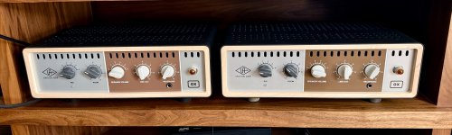

It’s so nice I bought it twice:
I actually own a Ox Stomp too that I use with a Suhr Reactive Load. The Suhr is a slightly better attenuator but the speaker-cab-mikes simulation in the Ox stuff obliterates IRs. Not to mention the built in 1176 comp, plate reverb, and delay.

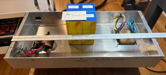

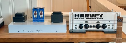

The custom chassis I ordered for my Model T build came in the other day along with the last few bits I hadn’t ordered yet:
Going with the same spec components as I used in my GT120 build except the extra chassis space is allowing me to take things further like: 10w non-inductive wire wound resistors, external fuse, individual external screw driver accessible full size bias pot, and external bias test point - for each power tube. Tocos pots. F&T multi cans for entire power string. Nichicons for the bias filtering. Correct Rogan witch hat knobs that start at 0. I did decide to go with the Marshall style lighted rocker power switch. The originals are available but they look cheap to me.
The chassis feels very spacious compared to the GT120 chassis. 21ā€x10ā€ vs 17ā€x7ā€.
