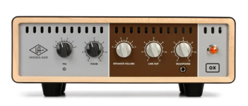

The solution that works for me is a attenuator cabinet simulation combo, and the best is the OX Box:
The attenuator itself is only slight worse than Suhr Reactive Load but the cabinet simulator portion is unparalleled. I am a DAW guy, so next to my rig I have a DAW with 10s of thousands of dollars of audio software, RME Babyface Pro FS , etc. I don't even have any real cabs at the moment(!!!). the output of the Ox hits my stereo board and then the Babyface which is configured to route that input directly to the output so there is no AD-DA conversion or lag before it goes to my monitors: Focal Shapes and a Focal Sub One (100W sub).
Chances are if you listen to a guitar "pro" on youtube you have heard the Ox. The reason is simple, it sounds great with little effort. Here's the big but: It sounds like a pro recorded guitar rig, like on the "hit records", not like you are in the room with the cab.
The Ox Box has wifi and I connect wirelessly to my two Ox Boxes. The software is fantastic and features are huge:
You get a great selection of cabs, mics, EQ per mic, master EQ, the great UA 1176 sim, delay, and plate reverb. 6 presets on the front dial. I actually hardly touch the software. It sounds alive, not flat like an IR. The cab sims are the reason the UA amp sims sound so great IMO.
The next big but is price. We all can't be "rich bitch!" lol. These have been around for a while and you can find them used at decent prices. I bought one new (on sale), and another used. The other option, and what I started with, is the Ox Stomp and a separate attenuator. I have one of these too, paired with a Suhr Reactive Load. The software app for the Ox Stomp isn't as pretty, IOS and Android, and connects via Bluetooth but it has all the same features as the Box.
Anyway... it's a great setup if primarily want to record, the barriers to record are way way smaller, you don't have to be a audio engineer for it to sound great, and it can as quiet as you like - I like fine French made studio monitors in my face paired with a big sub haha.
