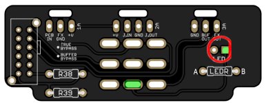

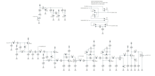

Because of some confusing and conflicting notation on AionFX's PCB, their build docs, and google search, I put the LED in backwards and then totally roasted the pads on both sides trying to get it out. I'm hoping that someone here can take a look at the schematic and find a fix by means of jumping the LED anode and cathode to a couple of other pads. If not, all good. I'm still learning.
(The LED stage is the top left portion of the schematic)

I am able to jumper the LED leads from the 3A and LEDR pads above and below it and light the LED up, but this results in just an always-on state and does trigger with the switch.
If you can make it out in the Imgur photos, the semi-circle symbol at the LED on the PCB points the flat side on the outside. However this is apparently backwards (according to replies I got from a post on diystompboxes forums), and they said the flat side of the LED itself needs to face the inside and lay opposite of the PCB marking. I originally soldered it aligned with the printing on the PCB because I assumed thats how it worked but apparently not.

Diodes. The first stage set of diodes should have a higher voltage than the second stage. Ge diodes 1n34a are usually the n the .3v range. What I usually do is socket the diodes. Play around with led, 1n914, 1n4148, bat41 or bat46.
The difference between the aionfx cygnus and pedalpcb g2 is the buffer.
Jumper from Footswitch pad highlighted in Green to Cathode( Flat side) of LED.
With the Anode side of the LED, you need to know which side of LEDR has 9 Volts. A or B
When you know which side has 9 Volts, Jumper from opposite side of resisistor pad to Anode.
If you look on the Backside of the PCB, you should see the Trace from LEDR pad to damaged Anode pad, that's what you need to Jumper.
You are a genius. Got it working!
Thank you
