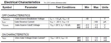

Compare that to the J201 spec:
According to those specs, the minimum Idss of the B245 is greater than the maximum Idss of the J201. In other words, their Idss specs do not overlap.
While it is possible that some BF245s might work is some pedal circuits that specify J201, I would not count on it.
