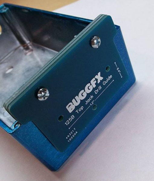

interesting idea. should be handy. are you going to start marking the build docs to highlight the appropriate holes on the template?
and is there a template for the jacks?
PedalPCB
Administrator
Staff member
Yep. Neither of these are new, they've been available for a couple years, they've just been out of stock for a while.
I use the top jack template for almost all of my builds except projects that have a special template.
The 125B enclosure template doesn't work for all of the projects obviously, but when it is compatible it sure as heck makes things a lot easier.

I use mine ALL the time. The top mounted jacks one is helpful on all enclosure sizes, not just 125 B. Just slide it across to the edge for your in and out jacks on 1590DD/1590XX etc.
IPv6Freely
The front template is awesome, though slightly less useful since I'm always including a drill mark on my graphics anyway - though those not printing their graphics obviously don't have that luxury.
If you do another run of these in the future, maybe it would be worth marking each hole with a letter so in your build docs you can just specify which holes to drill in the doc? Or, in the doc just include a graphic of the template with the appropriate holes circled, on the same page as the off-board wiring, perhaps?
The top template on the other hand.... THANK YOU. This is the one that has always been a pain since obviously theres no drill mark on a graphic (though, now that I think of it, theres nothing stopping me from adding a plate to my pedals on the top... that would be a good place to put my name and stuff, or whatever).
One thing I noticed though is that it does not fit on my Tayda 125B powder coated enclosures, at least not the white one I tried it on. I actually ended up sandwiching in the two thin strips you'd normally snap off and throw away and now it's just a touch loose but at least it fits! I don't know if its feasible to maybe include a second spacer in the next run (the screws do barely hang on, but I may just superglue it all together) but figured I'd point it out.
