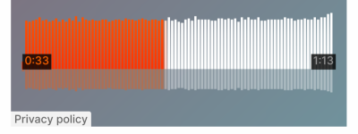

I included some sound clips as well. All of these were recorded direct into an A&H ZEDi10FX mixer into Reaper. The only effect used is the Dizzy Elk.
I am a terrible guitar player and am almost embarrassed to post these, but this post deserves sound clips regardless of my embarrassment, so here they are:
I was walking to work the other day and What's the Frequency Kenneth? came on my Spotify playlist and my god if it just didn't sound really close to this. I don't do the song justice, but I think you'll know what I mean:
So I did a terrible job with this - I don't have the subtlety to really nail this, but again, I think you can see why my brain thought this was appropriate for this pedal. I know that nothing *really* sounds like Spirit in the Sky, but I bet some of you could tweak this and with better technique get a lot closer than I can:
This last one is just me noodling for a little bit on bass. This is me slapping (!) on a P-Bass (!) with flats (!) - that sentence would get me thrown into the brig on Talk Bass, but this pedal makes it possible. A compressor is needed for sure (these were all recorded with only the Dizzy Elk) but the bass comes through really well here, and even the strumming is articulated fairly well. I think that's kind of amazing for how intense this pedal can be. YMMV.
