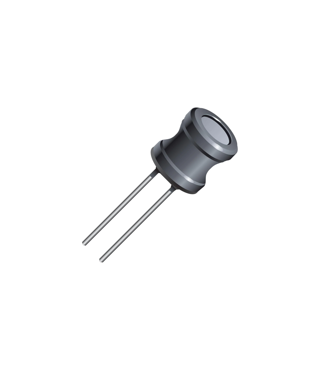

Also, will a 100mh work in place of the 47mh inductors? I accidentally ordered the small versions for tube breadboarding and they are the same footprint as the 47s. Just wondering what doubling the mh would do sound wise. If no good looks like I’ll be placing another order soon. Lol.
So after doing a Google dive, looks like it will shift the Q range enough to not want to swap them out. Looks like the two of them are linked up so possibly already at 100mh together. Where 2 100s would put it at 200mh. Looks like the 47mhs will be added to a missing parts order soon to be placed.
