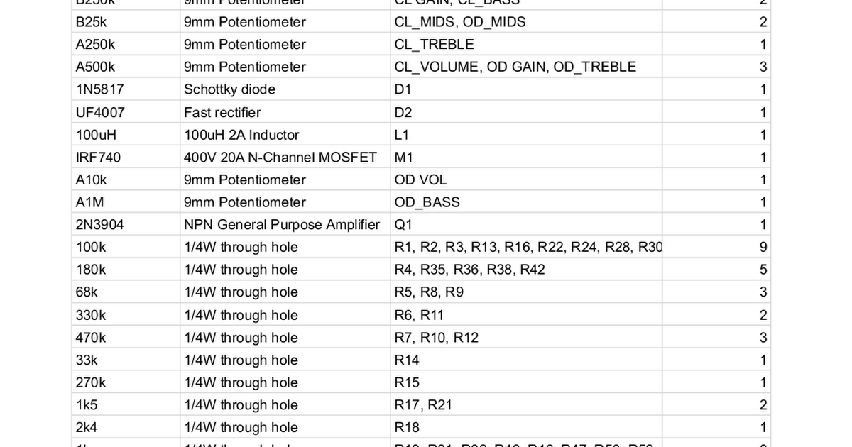

Sure thing. I don't really want to do a full build instructions for this one, so I may just give you a BOM and a schematic and a couple pointers then tell you to go for it. If you've never built a Sushi Box/C2C pedal before, this is a terrible one to start with, so hopefully you should be able to figure it out based on what you know of the others.Do you mind posting the parts list so we can see what needs to be ordered?
What is the minimum requirement for Power Supply?Sure thing. I don't really want to do a full build instructions for this one, so I may just give you a BOM and a schematic and a couple pointers then tell you to go for it. If you've never built a Sushi Box/C2C pedal before, this is a terrible one to start with, so hopefully you should be able to figure it out based on what you know of the others.
Supersonic Parts List
Sheet1 Comment,Description,Designator,Quantity 22n 630V,Film cap, HV,C1, C2,2 2n2,Film cap,C3,1 3n3,Film cap,C4, C17,2 100n 630V,Film cap, HV,C5, C27,2 22n,Film cap,C6, C13,2 330p,Ceramic capacitor,C7, C8, C19,3 47n,Film cap,C9, C24,2 470n,Film cap,C10,1 4u7,Electrolyitic capacitor,C11,1 2u2,Ele...docs.google.com
