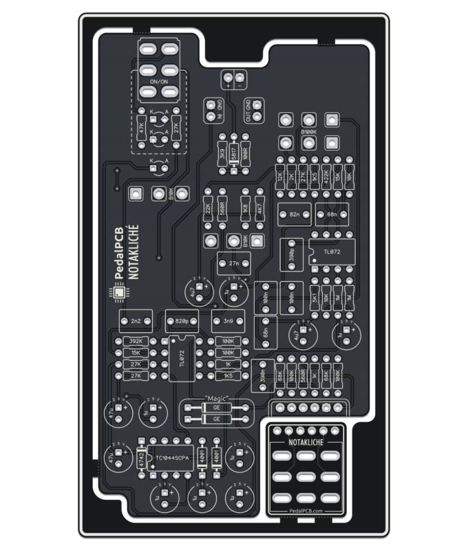

@Robert so is it a part for part Klone with a Clipping switch?
This seems... odd? Schottkies in parallel with LEDs would basically make the LEDs useless anyway, as only the lower forward voltage drop diodes will clip.The NOTAKLON uses schottky diodes instead of germanium and is true bypass. The Shamrock switch throws a pair of LEDs in parallel with the schottky diodes and drops the value of R15 (in the Kliche) to 27K.

Edit - okay I've now brought it full circle with my other not Klon clones (at least in spirit)
Though on further reflection I may like it rearranged this way better:
