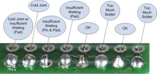

I agree with Nostra, first thing I saw was possible cold solder joints on that left footswitch, Since you haven't got any pictures of the solder side of your board we have to suggest the issue may be your soldering. Go back and check under magnification & good light all of your solder joint. Reflow any that look off, you may find it works after that. If not a picture of the solder side will help us help you. Majority of these issues are wrong component value or a cold solder joint. Once you have thoroughly checked components & solder work let us know.
