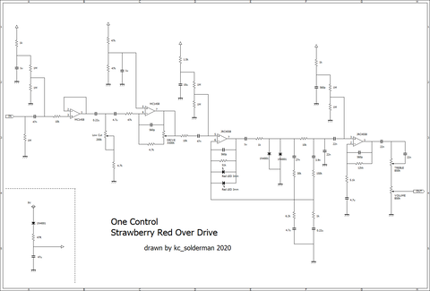

The red diodes are in the feedback loop. I like the sound of this pedal better without the red diodes because there is still ample drive but more high end definition. I tried a few other diodes instead and so far the BAT46 do it for me. Here is the schematic --

Are you able to attach a higher resolution version of the schematic? For some reason, it's tiny on my desktop screen.
that is the only version I could find. you can do a google image search for "strawberry red overdrive schematic" and get a link to a non-English site with the image.
The image-link in Zgrav's post#15 was to the thumbnail on the Japanese site, not to that website's thumbnail's linked large graphic.
I've taken the liberty of translating the page with Google-translate; I was going to omit the images, but in for a penny... However, I have not linked to the larger schematic as Coltonius has already provided it.

I analyzed Strawberry Red Over Drive
A while back I got a ONE CONTROL Strawberry Red Over Drive.
I've been curious about the good reputation of this effector for a long time, and I bought it because the junk product with the broken bass adjustment trim was cheap. This mini pedal series from ONE CONTROL often uses trims for fine adjustment, but looking at the net, it seems that they are all fragile.
I disassembled the whole trim to repair it, but I suddenly thought of it, took a circuit diagram and made a clone.
I've seen a lot of overdrive circuit diagrams, but I'm not sure if they're correct because there are circuits that I haven't seen anywhere else.
The sound output from the finished effector was almost the same as the original, so I don't think I made a big mistake.
By the way, in the actual machine, the Low Cut trim uses a small variable resistor that can be adjusted with a thin screwdriver through a hole on the side of the main unit.
I found this circuit interesting for two reasons.
One is how to make a polite bias. Normally, if a bias power supply is made in one place, it is distributed to the necessary places in the circuit. Looking at the circuit diagram, I made it four times.
This method increases the number of parts, but since each power supply is independent, I think it is resistant to noise without being affected by each other's circuits. Perhaps this is because the board is divided in order to fit the parts in this effector in a small frame.
The other is a distortion generation circuit and a filter. The distortion of this pedal is a series connection of two types of distortion: diode clipping distortion in the feedback circuit of the op amp often used in overdrive, and diode clipping distortion in the signal circuit used in distortion. And after that, parallel ✕ double stack? A filter that combines a resistor and a capacitor. I saw this for the first time. how should i calculate it?
Two operational amplifiers are used, but the model number is deleted.
However, a small operational amplifier for surface mounting is easy to erase.
I was able to confirm that it starts with "4", so it's probably 4558.
The other one has the model number deleted, but the layout of the deleted character string, the shape of the package, and rumors on the Internet? Based on the above, I decided that it was the MC1458P made by Texas Instruments.
This photo was used as a reference. A flat package with almost no unevenness, two lines of text, and some symbols at the beginning of the text match.
This time, I noticed that a printed character string or a two-line DIP type operational amplifier is actually very rare, and it seems that this was left after the process of elimination.
