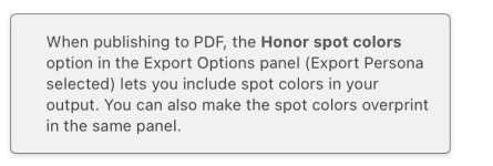

I wouldn't even know how to check that to be honest lol.That's interesting, even using the palette you had posted? Did you double check the export settings so that it honored spot colors?
Well shit. I’ve never even checked that lol.via: https://affinity.help/photo/en-US.lproj/index.html?page=pages/Clr/spotClr.html?title=Spot colors
Acrobat preflight can also confirm if spot colors are embedded correctly in the “separations” section of advanced print settings
