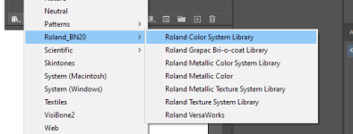

I'm at this step now. I vectorized an image at autotracer.org and it seems to have 100+ elements. How do I apply the proper swatch to it?
The brighter red one, barely looks like a bison.. it's pretty blobby lol.. the first two look pretty good..
Are you using Affinity, or Illustrator? About a quarter way down this page you'll see the link to download the Roland VersaWorks swatch. You'll
have to import it to your program.
To note.. with Affinity, you have to ensure when you add the RDG White and RDG Gloss to your designs, you're going to want to ensure the swatch is both highlighted and has the little dot.

Took me a while to find the swatches is the only reason I emphasize that. Here they are for Illustrator http://files.fine.rip/pedals/Roland_BN20.zip
So wintersoldier was helping me. He suggested that I could import just the colour layer from Affinity as a pdf into AI and duplicate the layer. I did this and re labelled it as White. I had imported the Roland Versa swatch and went to apply the white part to the layer but it looks grey. I suspect I screwed up this step?

No, the “RDG White” is intended to look grey on your monitor. It will print as white.
Thanks. I thought I messed it up and I was supposed to go into the brushes section and select white after selecting it in the swatch.
I assume the order is important? ie. White 1st, Colour 2nd, Gloss 3rd?
