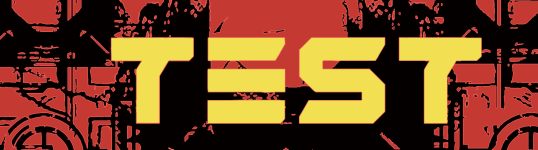

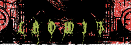

I think I have only posted here a few times but lurk from time to time and think I have travelled this thread many times since the pandemic hit. In doing so I have lusted after seeing all of the beautiful results folks are getting with Tayda. And I recently saw a Tayda print in person that a friend made so I am finally going to try out their UV printing service soon. I also have been etching enclosures for my builds for 10 years so exciting to get more into color work as all of my designs have been made in black and white in photoshop. through my job I have creative cloud but only recently have been tinkering in Illustrator mainly trying to prep work for this purpose.
I have a simple question about the Tayda's color layer. Say I have multiple color layers in photoshop. In the examples I have attached I have colored fonts over black and black over red. If I merge these into one color layer is that fine for printing or do I need to make sure there is no black or red under the fonts? Or no red under the black, etc? Just want to make sure the printer won't read another color under another color if the layers are merged. Once I merged the layers in photoshop, I would import the PSD into illustrator and run image trace which I have learned. Hope that makes sense. Basically, I work in photoshop as I do a lot of copy and pasting of elements to create my graphics. Thanks in advance! -Richard

You're going to want to make sure that only visible objects are active in the color layer. After converting all your text/objects to curves, you'll want to add/subtract objects in your color layer until the color layer does not have any overlapping objects. This is done a LOT easier in a vector program (like Illustrator or Affinity Designer) versus trying to do this in Photoshop.
I don't know if this helps, but you can have RDG_WHITE under as much or as little of the color layer as you prefer. Personally, I like to create a copy of all objects in my color layer and place them in the WHITE layer. By doing this, I have white under everything and I find that color objects tend to look more accurate after printing.

That’s what I did as well. It’s very important to subtract the non visible parts.

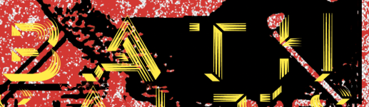

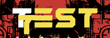

Hey, thanks very much for the replies. I plan on adding a white layer copy of the color layer per Tayda's instructions for sure. After reading your replies about not having overlap on the color layer I did some googling about how to subtract anything in color that is not visible by whatever is on top of it and didn't really find what I was looking for so I did a quick test with 3 colors that were all individual layers in photoshop. I then merged them into one layer and saved the PSD file. I imported that into illustrator as shapes and then did an image trace. Once that was done I expanded the trace and it looks like there is no overlap with the colors. In the screenshots attached, the first one is the image that was traced. And the 2nd image, I moved the T in test and looks like there is nothing underneath it (black or red) so I think I should be good to go!
