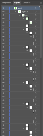

Tried importing some of my now-completed Inkscape SVG graphics into illustrator to apply the swatches to the white and gloss layers. Getting this message…
“clipping will be lost on roundtrip to tiny”
Anyone know what this might mean? Everything is fill-only vector graphics, so not really sure what the problem might be.
You have an SVG Tiny file for some reason and it has a clipping mask in it. Try it and see what happens. Otherwise, either open it in a browser and print as pdf or send it to me and I can check it out for ya.
