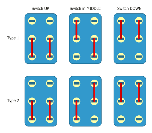

However, it’s more complicated than that! There are two configurations of on-on-on switches, that have link different pins when the toggle is in a given position—so you need to use the correct type.
Here’s a graphic lifted from a @Feral Feline post from a few years ago:
That shows the difference. I ran into a few head banging why isn’t this working? sessions until I found this out.
