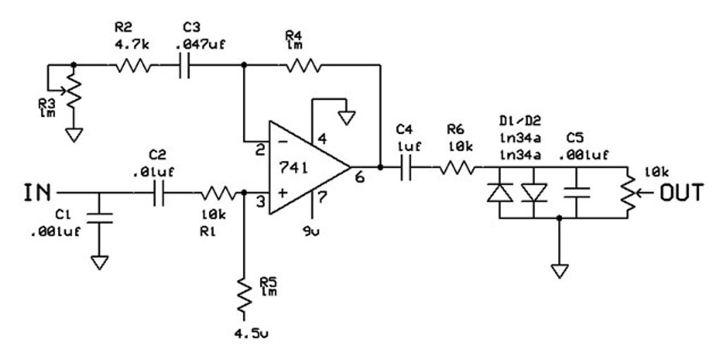

Here's a stock Dist+ where the GAIN is wired as a rheostat going to ground:

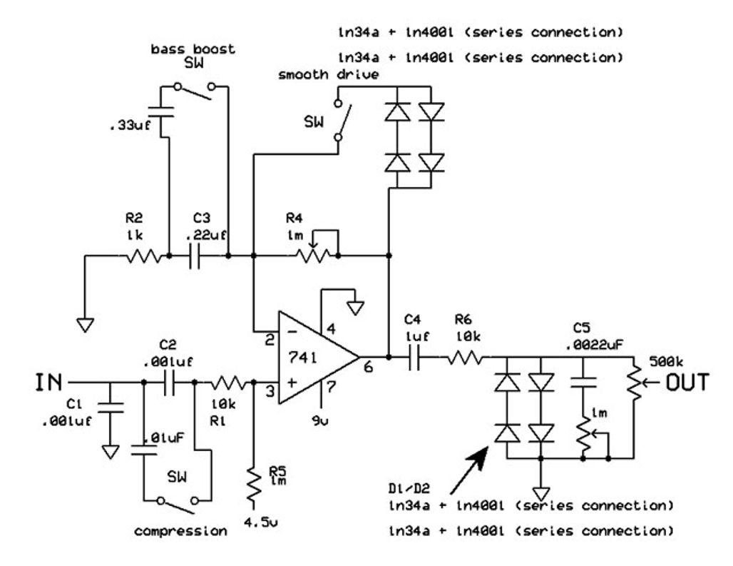

Increases in Gain affect the bass response of the circuit, which may not be to your liking if you want a gain increase without the EQ swing. Brian Wampler has a mod for that, moving the GAIN control to where R4 is for a less obvious EQ change:
Read more about his above mods in his Premier Guitarticle.
