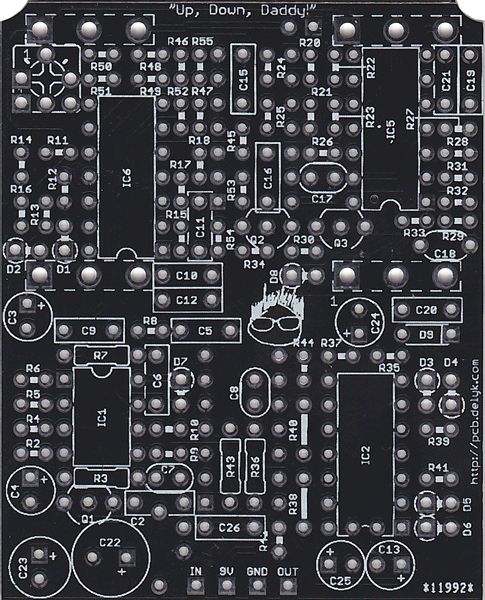

I forgot about this one, I’ve built it as well.
Thank you. I'm now on the waitlist for this one. Since Madbean's Lowrider is discontinued, this seems a good alternative.
