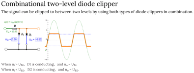

So what you mean by that is they’re likely applying a positive DC offset to control the threshold of clipping on the positive peaks of the waveform, then applying a further negative DC offset to control the clipping threshold of the negative peaks of the waveform, and then nulling the final DC offset before sending it to whatever post-clipping stages?In terms of how they're approaching this from a technical perspective, I can think of a few ideas, but I think the most likely option is with Biased Diode Clippers - Basically using a voltage source to positively or negatively bias the audio signal, effectively moving it to a different part of the diode I-V curve. Independently controlling the positive & negative bias would be an effective way to control both the amount of clipping, as well as the symmetricity/asymmetricity.
