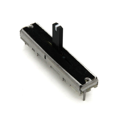

+1 on that. mouser seems to be out of stock too, and I can't find any other brands with the same pin spacingTayda seems to have been out of the sliders for a while. Anyone know any alternatives that work?
Another Option:Since it’s safe to assume that Tayda is never getting those B50k slider pots back in stock, is anyone with the relevant smarts (*cough* @Chuck D. Bones *cough*) able to take a stab at what differences, aside from taper of course, W20K pots would have in the circuit from a technical standpoint?
If I’m being honest, I still don’t really understand what difference the pot values make when acting as a voltage divider in this particular sort of application.
I’d have to learn more to answer about how the different values effect the sound in this spot of the circuit. But, I can tell you that the 1776 Effects (currently not taking orders) has a six shooter project which is the identical circuit as Pedalpcb, except it uses all w20k potsSince it’s safe to assume that Tayda is never getting those B50k slider pots back in stock, is anyone with the relevant smarts (*cough* @Chuck D. Bones *cough*) able to take a stab at what differences, aside from taper of course, W20K pots would have in the circuit from a technical standpoint?

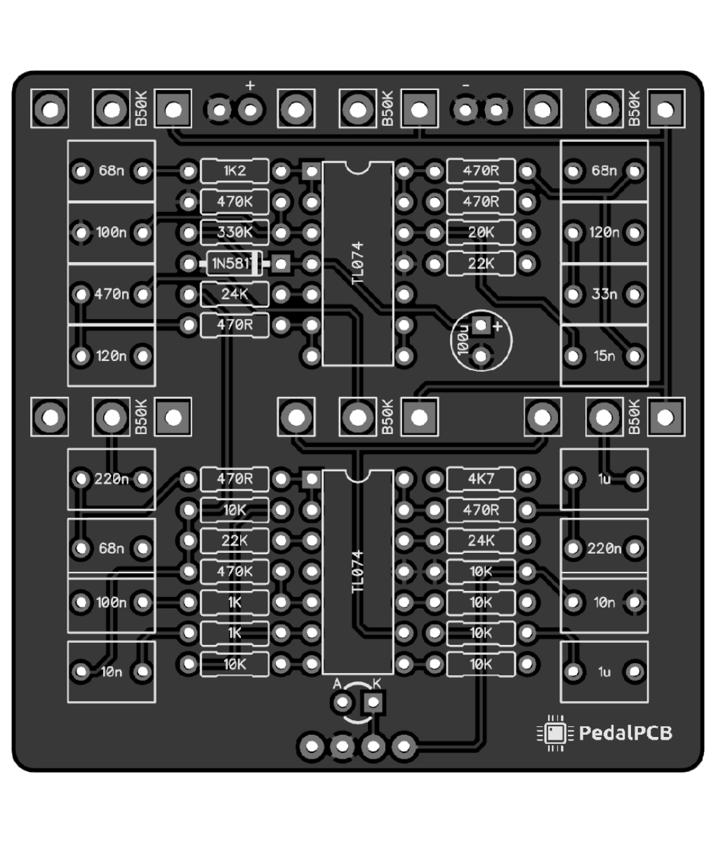

i struggled at first with caps too. its easy though. when searching tayda you need to search 100nf for the C1. . and so on... c2 search for 10nf. As far as brand of caps go, I usually go with kemet or faratronic, they are cheap but i havent had any fail yet. here is an example of the 100nf film cap for c1. same goes for searching for electrolytics, just add the "f" to the value listed in the build doc. for this build you only need one electrolytic cap. the value is 100uf. the main thing to look for on electrolytics is the voltage. it needs to be a little higher than the 9v the pedal operates at. i usually go with 16v or 25v for higher voltage pedals. hope this helpsHello everyone. I'm new here, so hopefully it's okay for me to tack-on to this thread with this.
I'm a noob builder and I want to try building this: https://docs.pedalpcb.com/project/6BandEQ.pdf. Trouble is, the parts list is somewhat mystifying to a noob -- most notably (to me), the capacitor section. In my opinion, the parts list is geared more towards a more-experienced builder. Sourcing the parts on my own has been somewhat of a challenge. I just don't want to order all these parts, and make a huge noob blunder...
Is there anyone out there that can help break down this entire parts list with more info? Namely, the key info that would help a noob source these parts -- i.e. the product specifications that one would normally find on, say, a Tayda product page. Example below.
Saving that, help list the Tayda part # for all of these line items?
I know it can feel like a daunting task, but there's not really any way around just trial and error. The only easier way would be to order a kit - although Coda Effects and I think Aion have some resources on parts sourcing?Hello everyone. I'm new here, so hopefully it's okay for me to tack-on to this thread with this.

NOW, where the hell can I get those danged slider pots for the 6-Band EQ!?! ANYONE!??!
stompboxparts.com
Thank you! A lot of the initial tips you listed I had pieced together, and amassed a Tayda shopping cart therefrom; but, I have a couple follow-ups...if you will? (and thank you kindly!)i struggled at first with caps too. its easy though. when searching tayda you need to search 100nf for the C1. . and so on... c2 search for 10nf. As far as brand of caps go, I usually go with kemet or faratronic, they are cheap but i havent had any fail yet. here is an example of the 100nf film cap for c1. same goes for searching for electrolytics, just add the "f" to the value listed in the build doc. for this build you only need one electrolytic cap. the value is 100uf. the main thing to look for on electrolytics is the voltage. it needs to be a little higher than the 9v the pedal operates at. i usually go with 16v or 25v for higher voltage pedals. hope this helps

Thank you! This is a very detailed response. I'm super grateful! You're right, I totally need to figure this out all by myself. I'm learning a tonI know it can feel like a daunting task, but there's not really any way around just trial and error. The only easier way would be to order a kit - although Coda Effects and I think Aion have some resources on parts sourcing?
I don't think anyone will give you a ready made list since it's not that hard, and you will have to learn it eventually.
For the 6 band EQ, it's actually very easy. Just one electrolytic capacitor - pick at least 25V, 35V is a bit better since it also works with 18V pedals (in case you order more in the future for other pedals). With electrolytic capacitors you have to pay a little bit of attention to the size - mainly in that larger ones can get big if you get a 100V version or whatever. But stick with 35V, or 25V if they seem to get really big - Tayda lists the sizes in the names usually.
For film capacitors it's quite easy, for example the 100n capacitor, you just search for "100nf" on Tayda (the capacitor values are measured in farads, so the 100 nano farads) and you will find a bunch of them. I just pick the cheapest Polyester Film Box Type Capacitor. Only thing to keep in mind is that you don't want SMD film capacitors. They are very tiny, and don't have legs that could go in the holes. Here's an example of the 100nF one, just pick similar looking ones for the other film capacitors https://www.taydaelectronics.com/0-1uf-100v-5-kemet-polyester-film-box-type-capacitor.html
You can also check the sizes to make sure they fit, but I've never had issues with those. The bigger ones are 5mm wide (or often can be 2.5mm wide too, that's fine if they're smaller) and smaller ones are 2.5mm. For 1u you might find both film and electrolytic, so check which ones you want (film in this case). They're not interchangeable since electrolytics only let current through in one direction (for DC), although there are also bipolar electrolytics - they are rare though, just avoid them for now.
Remember to get sockets for the op amps (well, you can also solder them in directly, but there's a chance you could burn them if you keep the iron on for too long), I like these https://www.taydaelectronics.com/8-pin-dip-ic-socket-adaptor-solder-type.html
Also remember the input/output and DC jacks (there are different sizes for DC jacks), LED, possibly LED holder or lampshade clip (these also have different size holes for them, and LED's came in 3mm and 5mm usually), plus the 3PDT switch for the footswitch. And some wire, I use solid wire, stranded is more malleable but it can be annoying to get through the holes on the PCB.
You can get all the resistors easily from this page https://www.taydaelectronics.com/resistors/1-4w-metal-film-resistors/test-group-2.html
