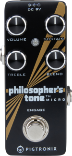

How Good is the Philosophers Tone
All the reviews rave about how good it is!!!
Wait a minute, it's not even the same Circuit anymore!!!
Where's the Grit control????
This is the Current version that has been available for 6 years!
Famous for its noiseless clean sustain, the Philosopher’s Tone has staked its claim in the crowded world of compressor pedals. In addition to Volume and Sustain controls, the Philosopher’s Tone features a parallel Blend knob that allows the musician to mix their instrument’s original tone with the compressed sound effect. This technique restores natural pick-attack and allows more extreme sustain settings to remain musical. The Treble control provides up to a 6db cut or boost at 2kHz for fine-tuning the frequency response of the effect. The Philosopher’s Tone features true-bypass switching and internal 18V power rails for maximum clean headroom, even when used with hot pickups and line level signals.
This sounds more like what I was expecting. I wonder if it's even an optical??
