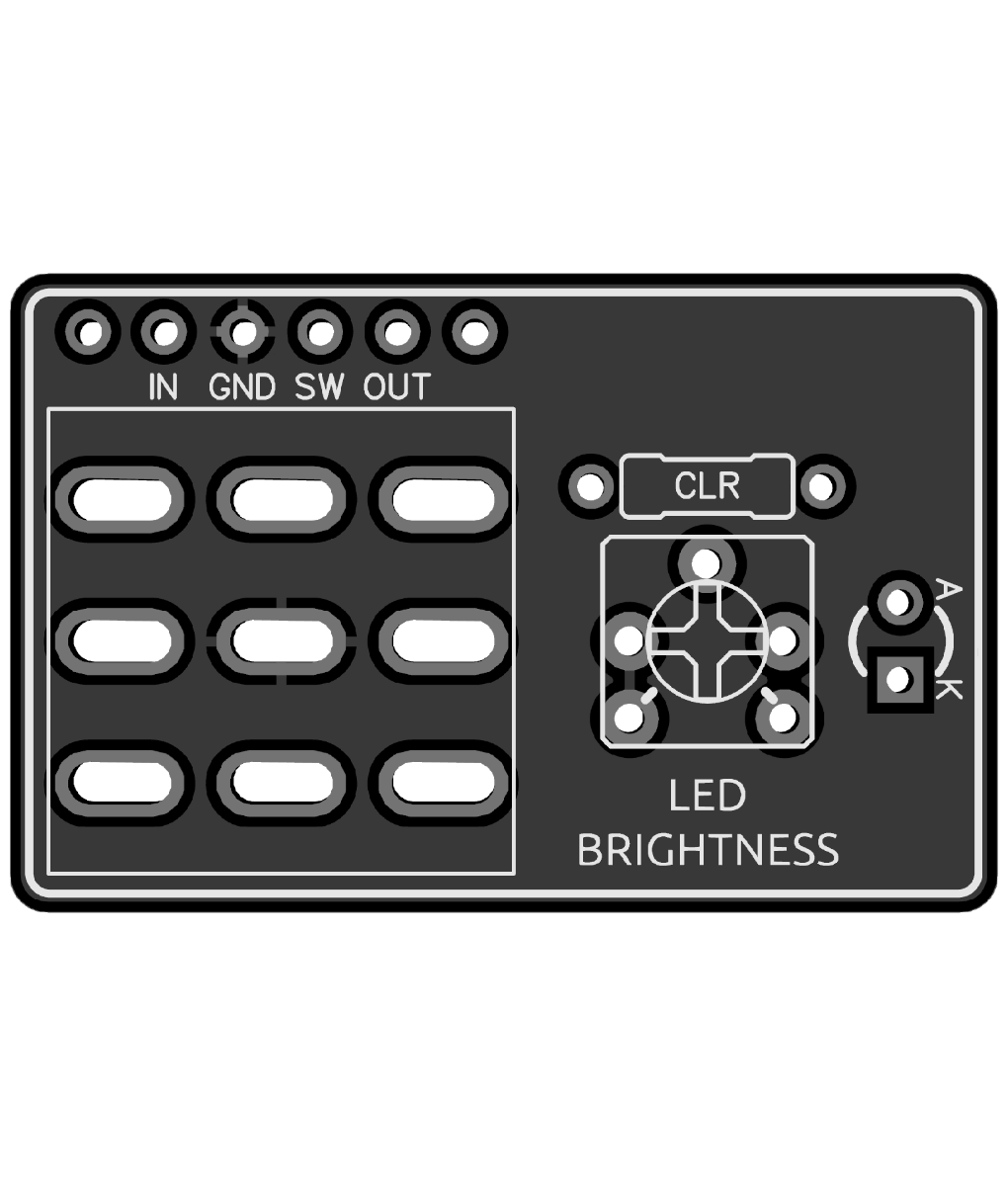

Sooooo, about the LED. Normally after using the test platform I wire it up in the enclosure, but that has only been with PedalPCB boards which have the LED pads.
I have a PedalPCB 3PDT breakout board with the LED pads soldered to a footswitch already. Do I disconnect all the rest of wires at the bottom of the test platform and attach them to the daughter board? Would that work the way the test platform is constructed?

With this Blue Sheep PCB, the SW pad is +9v so you connect that to a wire with CLR (resistor) to the Anode on the LED.
The Cathode side of the Led connects to a wire to the PedalPCB footswitch SW pad.
This Blue Sheep design is for a Footswitch PCB with CLR & LED on board !

I already have a breakout PCB soldered to a footswitch but I should do this with a loose footswitch? And lug 4 is the SW one on a footswitch, right?

All you have to remember that on this PCB, the SW pad is POWER and it has to go to the Anode + side of the LED.
The Cathode - to centre top lug of the Footswitch, The Current limiting resistor can go on + side or - side of Led, it will still work!
Simply put, your issue on the Test platform is the led wiring is reversed which caused the short coz power went to Ground.

Also possibly worth noting for whomever might run across this: we talk about the 3pdt turning the pedal “off” or “on” but that’s just convenient shorthand and not entirely true lol. As wired here If the board is plugged in, it’s getting power and is “on”. When engaged, the switch simply completes the circuit to let the jacks talk to the board and make groovy sounds. When in bypass, the in and out jacks are connected directly, bypassing the board, disconnecting the LED, and sending the effect input to ground.
