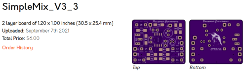

Does anyone have tips for laying out IC heavy designs? I feel so much more challenged by them than transistor based ones.
I am by no means tenured, but I have found the following useful:
  • Use dual opamps over quad. Just easier to place stuff.
  • Place your non-movable components first (IO/pots).
  • Follow the schematic and group components in logical modules before placing movable components. Treat the module as a single unit for placement, then optimise. For example, in your schematic above, C1/R1/C2 would be a module (In -> opamp), R2/R3/C3/C4 would be the next, C5/R4, D2/R6, D1/R5/C6.. and so on.
  • I like to place my opamps PPCB style, tab high, so I place them (usually in the center so I get a nice channel in the middle for vertical traces) and then see which modules can go on which sides, and which need the center (because they span sides).
  • Once I have a rough placement, then I decide whether components are better vertically or horizontally. I try to get traces going into ICs/transistors as short as possible. Vertical placement can be nice when there's a lot going in the feedback loop (like the Wise Sheep above).
  • Then optimise for shortest traces and practicality (can't solder a pot when you can't get the iron to the pads because it's got e-caps all round it..

Also here's a rough attempt of the schem I posted! Not super satisfying of a layout but might reach the threshold of tolerable enough to get fabbed

Nice layout, only things I could mention:
  • The 1u film cap footprint is only 2.5mm, maybe want 4.5mm unless you have tiny 1u caps.
  • You could look at moving the charge pump into it's own corner. I didn't mention it earlier, but I "try" to keep all the power supply stuff isolated from the rest of the circuit where possible. That goes double for charge pumps.

Thank you! Good idea about the charge pump and good catch on the film cap, wish I had caught it before I sent it off! Guess I'm using MLCC or gonna make a film cap look like its on stilts!
