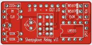

An improved basic relay layout. Takes both footprints of the relay I like, and you can lay the 47u flat to reduce the height.
You can also attach the SPST with solid core and the LED will align with Robert's enclosure standards, or you can attach the relay to the PCB with pin headers and wire with a LED bezel. I like the look of a naked LED poking it's butt through an enclosure, but the header approach is a lot easier.
