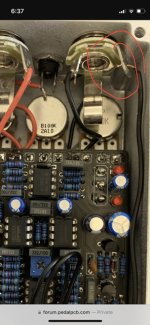

So, I was finally able to swap the pots around (broke them of and put new ones in) but the problem seems to have gotten worse. Any ideas? IMG_0311.jpg
