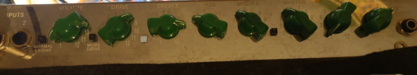

So, here's my problem. This is a Fender Hot Rod Deluxe amp. I've changed out the capacitors, put in a new speaker, replaced the tubes, biased new tubes to 69 ;), done all the Fromm mods, and I still can't figure out this problem. The distortion just sounds absolutely terrible. The audio example is of the amp's distortion channel, although every distortion/overdrive/fuzz pedal sounds the exact same. It's killing me that I can't figure out this problem, so hoping someone here may recognize this issue through the audio clip. I start strumming chords at :53 and it sounds ultra horrible then. Something is wrong with this amp and I can't figure it out.
I turned up the distortion and master just to make the crappy distortion easier to hear, it happens at every level, changing the EQ does absolutely nothing.
