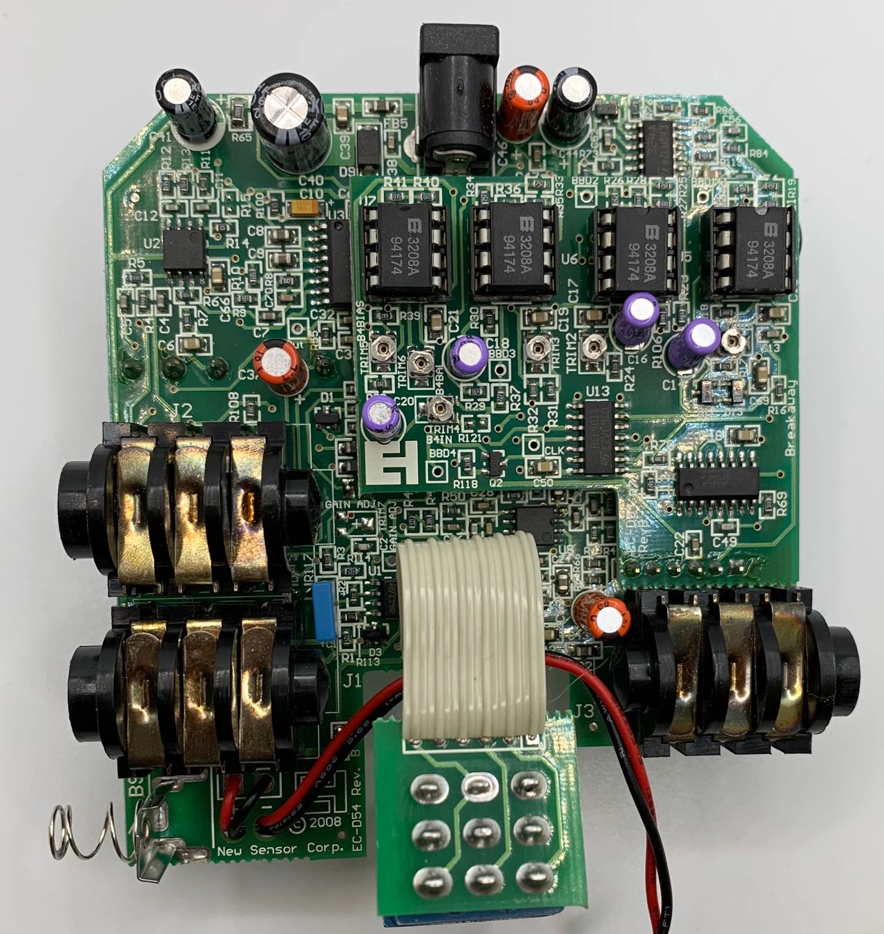

Some pedals use a spring or something else conductive from the PCB to the enclosure when the build requires isolated jacks, EHX does it a fair bit:

EHX Memory Boy, Spring Method (lower left corner of PCB near battery snap):
