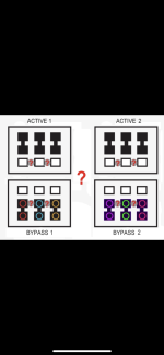

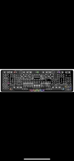

Hello everyone thank you for the help ahead of time. I recently built this paragon overdrive. When I had first plugged it in the left side would go in and out with audio if I moved it, so I took it out of the enclosure and the problem still continued. I also noticed that the right side would not produce any sound when engaged. Also when it was engaged it would cut out the sound that I was receiving from the left side but the sound would return when I put the right side back on bypass mode… help!
JRC4580 (Left):
1: 7.88
2: 7.88
3: 7.16
4: 0
5: 7.83
6: 7.85
7: 7.85
8: 15.65
JRC4580 (Right):
1: 7.82
2: 7.82
3: 7.11
4: 0
5: 7.80
6: 7.80
7: 7.89
8: 15.59
TC1044:
1: 8.86
2: 5.37
3: 0
4: -2.82
5: -2.78
6: 3.97
7: 5.15
8: 8.81
PWR:
8.44
1n5817:
North from left to right: 8.44 13.04 13.04
South left to right: 8:51 8.49 15.53
I had continuity at all marker!
