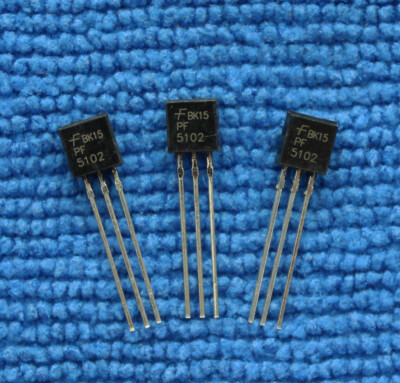

Q1 - pf5102:
pin1 drain= 9vdc
pin2 source = 0.2vdc
pin3 gate = 0vdc

got theses pf5102 from ebay

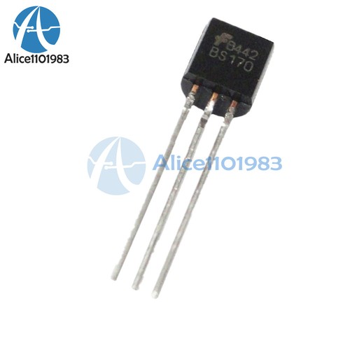

bs170 also from ebay

Q1 - pf5102:
pin1 drain= 9vdc - GOOD
pin2 source = 0.2vdc - BAD
pin3 gate = 0vdc - GOOD

Q1 & Q5 are out of spec at best, may not even be JFETs.
This is what happens when you buy JFETs on eBay. To paraphrase Forrest Gump: "Buying transistors on eBay is like a box of chocolates, except most of the chocolates have been replaced with turds."
So what to do about it?
Buy JFETs from a know good supplier:

They don't have to be PF5102 in this circuit. Most good N-channel JFETs will work as source-followers in this circuit. Ideally, you want ones with Vp close to -4.5V, but anything from -2V to -7V will work.

Just for completeness, measure Q6's drain voltage. Should be around 5V.
Your 5102 are probably bad or fake if they’re from a Chinese eBay seller. I found 2n5458 works the best in Rat circuits. BS170 are still in production so those should be fine... if your boost works that’s the only thing the bs170 is involved with so that’s a plus. Try some 5458s from smallbear or stompboxparts.

Q6 - BS170:
pin1 drain= 4.6vdc
pin2 source = 2.3vdc
pin3 gate = 0.2vdc

Q6's drain voltage is good. The gate voltage measurement is bogus, your DMM is loading down the circuit. That's why I didn't ask you to measure it.

It works now with the 5458 i got from ebay
