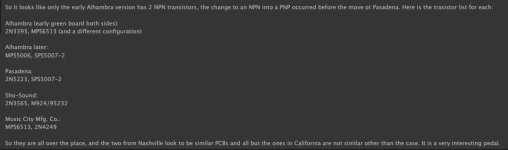

It's been a minute since I went down the Bosstone rabbit hole, but I'm a hardcore Spirit freak so I looked into them way before I was building anything. Here's one of the threads I had bookmarked from DAM, might be interesting. Post #33 here has more timeline pics. This has a quick demo of the trebly Alhambra V2, transitional Pasadena, and classic Nashville versions. There's also an isolated version of the song that helps you hear what's goin' on.
Transistor arrangements in each, at least according to that DAM thread:
