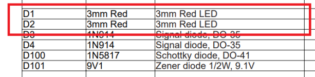

Also - I noticed you haven't populated the LEDs in the LFO shape circuit. Without these, your triangle LFO shape won't work.

There was a stray on the back side. I’m getting 9v to the board,but not through the 9V1 zener. I’ve ordered the leds and a new zener. Also no power to the switch. I hope it’s the zener…edit. I just misssed the leds. I guess I thought those were just power indicators as usual.

The good news is that you can continue troubleshooting without the red LEDs for the triangle wave LFO. Just know that the shape switch won't do anything until you get those red LEDs installed.
