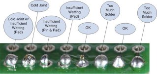

Most of your solder joints look cold. They should be nice and shiny little volcano shapes. Have you got a decent temperature controlled iron?
Yeah, I have a temp controlled iron. I run it at 480 celcius.
I see what you mean...basically all of my solders look like 1,2,4,or 6 in the picture above. Probably gonna trash the board and order a new one. Or find a new hobby hahahaha. I'm laughably bad at this one.
EDIT: Just watched a youtube video. I used no flux when I did this. It appears that I should have, and that I might be able to salvage this one by reheating my joints with some flux applied.
480's a wee bit high I run mine at 380 most solder will have rosin in the core depending on the type it's just a case of heating the pad and component leg at the same time and applying solder until it pools and flows nicely about 3 or 4 seconds
At a high temperature solder tends to blob up or go kinda flakey
