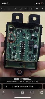

This pcb came from a vehicle interior with the board side seen in the attachment facing downwardly with some space below it. It was installed inside the vehicle. The car is about 2 years old.
Any idea what would have caused this corrosion on the transistor leads? The unit is not working and this would appear to be the cause. I cannot tell from visual inspection if any components failed.
Appreciate all the help I can get!

I already ruled out aliens, but this module is mounted in the center console between the vehicle seats with the side of the pcb facing downwardly so it is not clear how liquid would have gotten onto that side of the pcb, or that the corrosion could be just from a couple instances of liquid exposure, as opposed to just humidity itself causing it. There is a second same transistor nearby (not shown in the picture) that has the same thing - heavy corrosion on the collector terminals.
That is the real issue I am trying to determine and get input on - was this caused by liquid spills that crept under the center console top and somehow got onto the bottom of the board or would it have to have been some longer term exposure such as from humidity over the course of a couple summers, or something else?
I haven't tried to resolder, but am considering that, or even replacing the two transistors ($.20 each) rather than $250 from the dealer for a new module.
- Jim

Here is the top of the module - a couple coaxial rotary knobs (function switch and volume pot), and a couple of micro-deflection switches. You can see a little water stain on the one switch, but again, how should that be able to get under the module and onto the downward facing side of the circuit board. Certainly possible to wick around the edge, but would that be enough in one or two instances to cause that corrosion all by itself?
Second picture is the full underside of the module with the two transistors that have corroded collector terminals.
Liquid could have passed through those through-hole vias beside the transistor (there are probably more underneath the other transistor).
Just because you have obvious water damage in one spot doesn't necessarily mean the liquid was confined to that area the entire time. It also could have flowed around a bit while the vehicle was in motion.
If it were caused by long term condensation or humidity you'd think the damage wouldn't be localized to one area like that.
I'm surprised that module doesn't have some form of protective conformal coating, things like that usually do... The one time goop would have actually been beneficial...

Yes, agreed on the more uniform corrosion if it was precipitate from high humidity.
I said the same thing to the dealer about sealing the board. Right next to the cup holders is the most likely spill area and if the radio knob shafts and edges of the module were not sealed, then why wouldn't they have put a conformal coat over the circuit. And given that they told me this problem has occurred relatively often, it seems like it should be at least in part considered a design flaw.
