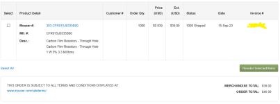

Sounds like a 1W 3M and 1W 300k might be much easier? Assuming you can find 300k's and the layouts don't cause issues with two resistors in series.The good news is I finally found 1w 3.3M carbon film resistors. The bad news is it was minimum 1000. The good news is that at that quantity they're only $0.039 each. The bad news is that's still 39 buck$ plus tax & shipping. This is the resistor that is needed on the reverb circuit for Fender (and maybe more) amps. And wouldn't you know it Tayda had 3M, but not 3.3M.... doh.....

I think I'd roll with a 3m resistor. Shouldn't it be within the realm of tolerance?The good news is I finally found 1w 3.3M carbon film resistors. The bad news is it was minimum 1000. The good news is that at that quantity they're only $0.039 each. The bad news is that's still 39 buck$ plus tax & shipping. This is the resistor that is needed on the reverb circuit for Fender (and maybe more) amps. And wouldn't you know it Tayda had 3M, but not 3.3M.... doh.....
Tone is in the toleranceI think I'd roll with a 3m resistor. Shouldn't it be within the realm of tolerance?
The blackface princeton reverb is one of those builds you need to follow the original layout to a T to avoid parasitic oscillation. I'd hate to use something out of spec, the cap that is paired with the 3.3M is 10pf. Soooo... right there is some odd mojo going on. I was specifically warned by someone that has built a ton of these to not mess with the odd layout as well. You can see it below, they're smushed together at a 45 degree angle. I really wanted to straighten these, since I'm building the circuit board. Not a good idea....!I think I'd roll with a 3m resistor. Shouldn't it be within the realm of tolerance?

So what you're really saying is you're organising a group-buy.The good news is I finally found 1w 3.3M carbon film resistors. The bad news is it was minimum 1000. The good news is that at that quantity they're only $0.039 each. The bad news is that's still 39 buck$ plus tax & shipping. This is the resistor that is needed on the reverb circuit for Fender (and maybe more) amps. And wouldn't you know it Tayda had 3M, but not 3.3M.... doh.....
