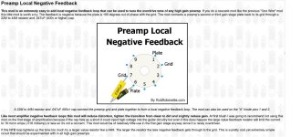

  3. 50M? Like 50MΩ? Like 50,000kΩ? I have never seen a pot that large in my life. What are you planning to do with a 50M pot?
What would I do with a 50M pot? If its as rare (i.e. non existent) as you say and I can find one I'll sell it at Southeby's for big $!! Seriously, if you'll look at the Robinette excerpt below you'll find he's spec'ing a resistor in the range of 22M-44M to go in series with a .047u cap. Something sound goofy about that? Maybe a misprint? But if its correct surely a 1/4W resistor is too punky. What should it be?
That value is fine as a resistor, but you're not going to find a pot that big, they just don't exist. If you want some variability you can do a 44M (if you can find a resistor that big) and throw another on a switch to parallel it to 22M. I haven't played with this myself, but it sounds like too low a value isn't going to be very useful, so you won't want to go down to zero, which means you may not find a pot there to be worth the trouble.
As for the resistor rating, this is where we dust off Ohm's law. If you're running 250V on your plates, then worst case scenario you're going to see 250V across that resistor. If your resistor is 44MΩ, then power dissipation across that resistor is going to be V²/R = 250²/44,000,000 = 0.00142W
You'll be fine with a 1/4W resistor there. BUT if you're running a pot, you're going to be in huge trouble because your minimum value is theoretically 0Ω, which means you will need a theoretically infinitely high rated potentiometer to handle it. So if you really want to use a potentiometer, put a 10M or so resistor in series with it so you have a minimum resistance and nothing will catch on fire.
