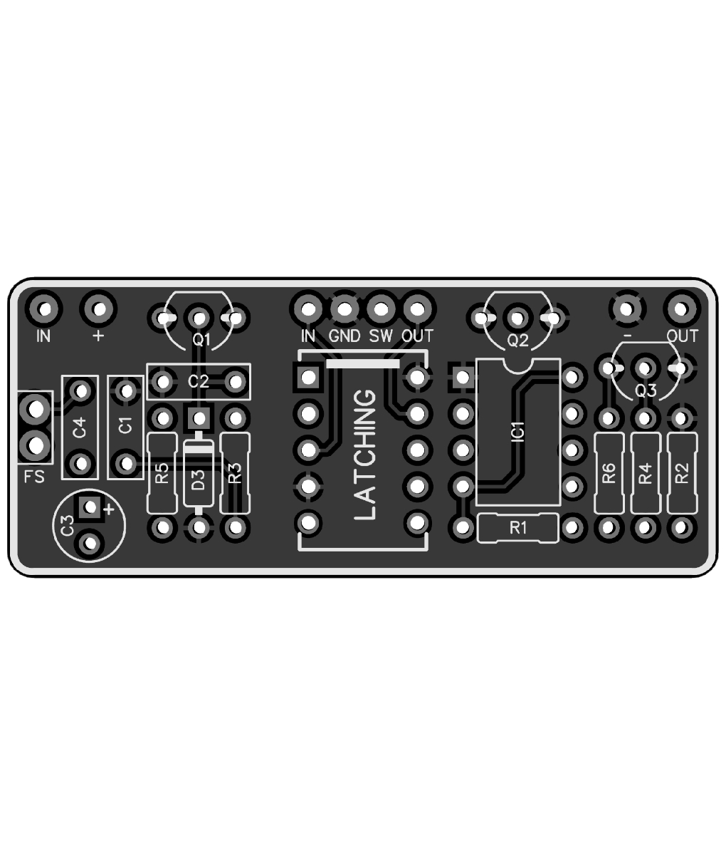

Trying to use a relay bypass for the first time in an Acrylic Overdrive (Wampler Plexi Drive) pedal I was putting together. The relay reliably turns on the effect but it has trouble turning it off/bypassing the effect. I'm trying to narrow down the issue before I just rip it out and just go with a standard 3PDT footswitch.
Here's what I'm seeing:
  • When first applying power, the LED is off and effect is bypassed
  • Upon pressing footswitch, the LED turns on and the effect is active. This works 100% of the time
  • Pressing footswitch again, nothing happens 95%+ of the time. The effect and LED remain on. Pressing the switch dozens of times, the relay eventually switches and bypasses the effect. I can't seem to find a pattern of when it actually works- just very intermittent.
  • Once off, the switch reliably turns the effect back on 100% of the time.
I didn't have a 10-pin socket on hand, so I soldered the relay directly to the board. I feel like I've seen others do that, and I was careful soldering it on, letting it sit for several minutes between soldering each of the 10 legs. Could I have fried it?
I did use a tantalum 1uf cap in place of the 1uf MLCC specified in the docs. Could that affect the behavior?
I tested the momentary footswitch with my DMM before I did anything else- I confirmed it's a normally off momentary switch by testing continuity. I had another NE555 IC on hand and tried that but same behavior. I'm using a TQ2-L-5V and I verified I'm using the right transistors, which I got from Mouser.
Anyone had similar issues, or have any suggestions?
Not the end of the world- I can just swap out for a standard footswitch if I can't figure it out, but just disappointed my first try at using relays isn't working.

Did you pay attention to the polarity of the tantalum? It wouldn't be marked, but the negative pin should be directly connected to ground.
Is that a TQ2-L5V ?
Edit: It appears that the negative lead should be oriented towards the top of the PCB.
