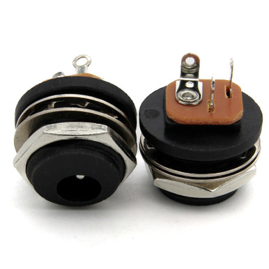

i recently made the decision to switch to these DC jacks since as far as i can tell they are the only affordable ones on tayda that are externally threaded. this allows me to mount and remove the whole circuit from the enclosure without having solder/desolder anything

How are you handing the positive-sleeve DC jack wiring?
You're going to run into grounding issues with that type of METAL-housed jack.

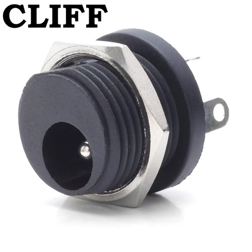

OK 16¢

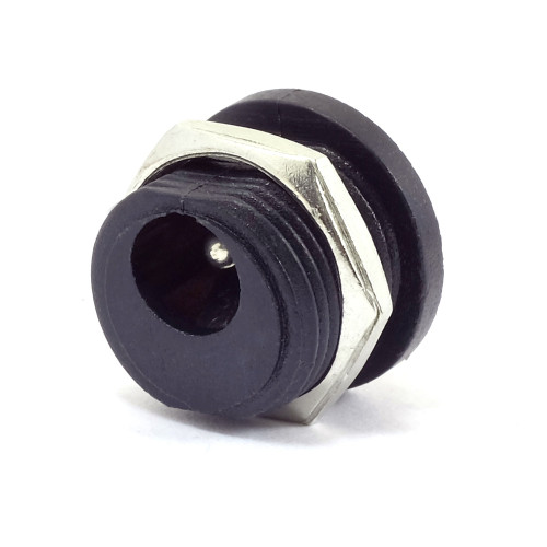

BETTER 65¢
BEST! $1.25
Don't buy outties online direct from China (unless you buy just a few to ascertain if they're any good and whether the vendor is reliable).
I bought a bunch of outties off TaoBao and they were of course objets d'art ie they looked like DC Jacks, rather than being functional units.
Better to pay a little more and get something that's got a higher percentage of being reliable. If I had a pedal business, I'd buy the CLIFF jacks in BULK.
For the hobbyist, 65¢ buys a jack that works and peace-of-mind.
For personal builds, 16¢ suffices.
