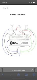

using their breakout board for the switch so I’ve connected it to I, O, L+, L-. Where / how do I connect the led? unless I double up a connection somewhere I don’t see where. L+ and ?
85AE988D-F3EB-4A06-A32F-4CAF61508DC9.jpg The diagram for the brutalist has it connected to L+. But since the breakout board connects to L+ and L- Im a little confused. I fee like I'm overlooking something obvious
Looks like you’ll have to do it off-board, since it doesn’t look like there is an onboard resistor for the LED. Connect a 4k7 to the + at the jack, wire the + LED led to the resistor, and run the ground to the switch…

Cool, thanks! Hopefully finish these up this weekend
