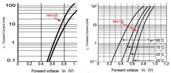

If you compare the If vs. Vf plot, 1N4148 is a pretty good substitute. It has a slightly different Vf, but unless capacitance or recovery time is critical to the sound, it should be a perfectly good sub.
Those do look pretty close.
On a Peak DCA55, I measured a bunch of the 1n4148.
At 4.274If, it’s showing the Vf is coming in around .670V, give or take a few thousandths, so that matches up pretty close to the plot.
Eyeballing the plot, the MA150‘s Vf looks to be a hair under .700V at around the same If.
