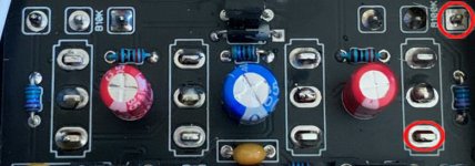

Ok, so this post relates to yesterday's Hydra build. You'll notice that I slightly borked the 100nF cap at top left of the gutshot.
I say this because of some weird behaviour as follows: In bypass, the LED glows dimly, which suggests TMM that it's still getting current from somewhere when it shouldn't. This is accompanied by a considerable pop when the pedal's engaged.
So question 1: is this cap related to the power supply as a filter which is now partly dysfunctional because of damage to the cap? If so, is there a simple workaround to fix this without removing the entire installation again? Reasoning immediately below.

Sorry folks, I mean 1nF, not 100nF (same position, at top left) and this low value is probably not related to any power filtering caps in this universe. I'll check for stray wires near the footswitch meanwhile. Still puzzled that the LED shines on dimly in bypass. Never happened before, but there's a first time for everything, I suppose.
This is C4 whic is part of a HPF before the FV-1 so this shouldn’t effect your LED or bypass popping.
Can you send pictures from the underneath of the board? Check for solder bridges around the LED and the ground wire at the bottom of the board.

This looks like No solder on bottom toggle outlined in red, The pot outlined in Red looks like a cold joint so reflow.
The togle solder joints look cold so I would reflow all of them.
I would check all your solder joints as cold solder will cause it to pop more sooner or later.

Yes thanks @music6000, definitely much room for a systematic inspection and reflow. Meantime, I did rework the toggles which now function according to plan. Missed the top right pot. Thanks again.

Cool, Here is a Continuity check you can do if this is the Damaged pad.
Make sure you have no power connected when testing for continuity.
This is also the best spot to jumper if no connection.

If the Geen pad is bad, it just needs a jumper.
If it's the red pad, that also connects to a R3 - 1K resistor just below the 1uF Cap.
One side of the R3 - 1K only goes to C3-1uF left pad down at Pin 1 of TL072, so check for Continuity at those pads also.
