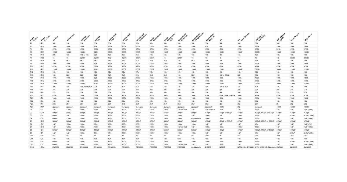

I made a spreadsheet of the values of different versions of Big Muffs and how the switches on the Muffin Factory should be set for the closest value to each version. I also added the Muffin Fuzz schematic references. This chart may be helpful to build your Muffin Factory or Muffin Fuzz with values more specific to versions you like.
I'll be going thru the Kit Rae site and adding more as time goes by, so check back for more. If there is a specific variant that you would like added that is not on the Kit Rae site, please post a link to the schematic.
Muffin Factory Settings Reference Chart
Note*** Most common variant of each version indicated in bold

There used to be a spreadsheet for the Mudbunny/Rabbit Hole (MBP Muff) floating about the ethers, originating from Juan Solo. Can't find it now, but I think I made a PDF on my old computer.
Here's a broad generalisation by Kit Rae of the different era-versions:
Thank you Aentons!
This?
Or
  • Big Muff Versions.pdf

Edit found the MBP ref-des PDF I made, but the URL is defunct so I made a JPG which had crappy resolution so...
A screen-grab of the PDF and Juansolo's your uncle:
Here's the Key to the blue-highlighted bits:
[1]
John Arnold:
This is inline with R6. The line is then pulled from between. As the Mudbunny doesn't support this, use a 10k as R22 instead

http://juansolo.co.uk/stompage/Muffs.htm Page 2 of 3
27/5/16 3:23 am
[20]
John Arnold:
Between volume pins 3 and 1
[21]
John Arnold:
Switched with D3&4
[22]
John Arnold:
Covered by the Schottky in R24
